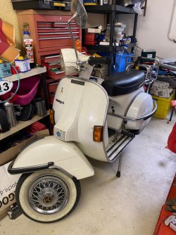

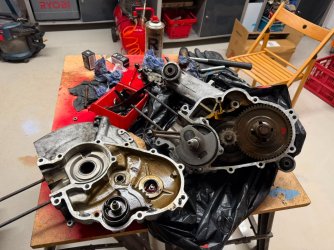

So - after some swearing and using a lot of hints from the internet, several tools that I was surprised to have and some tricks I developed to get the crank back in place, I finally managed to get the sucker back together with all new seals and gaskets.
Now I need to
-Sandblast the exhaust and get it re-painted
-clean the scooter itself
-install new rear shock
-get the engine in
-change the jets on the carburator and get it back onto the engine
-install all cables (2 x shifter cables, clutch, choke, throttle, all the 7 wires from the ignition plate connected to the right counterparts etc.)
-install new brake shoes and adjust the rear brake
-mount new tires (20 year old tires do not make sense...)
-find OT, mark 18° pre-ignition timing mark and check with the strope
-install the new front shock (44 year old shocks weren't the best anymore...)
-get everything back together
-get it MOT'ed with the new setup
Now I need to
-get the engine in

Surgery was successful, transplant has been accepted and the patient aspirates freely on his own. He is still on the surgery table but will be taken off after some more health checks and adjustments (clutch, shifter, rear brake, throttle, choke, ideal setting). Next surgery is in preparation (front suspension and tire), but we regard this as a success so far. Family and friends have been informed and are relieved. A full recovery is expected after the first 1.000km.
