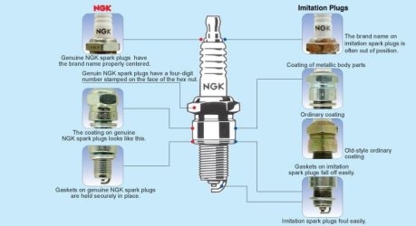

Beware of fake NGK spark plugs though. Some on-line suppliers sell imitation plugs. Buy your spark plugs from a reputable source.
