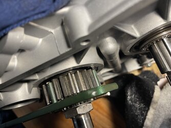

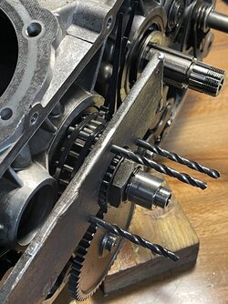

I had an idea to block the crank sprocket, very easy to do and works perfectly! I thought to share it here in case someday someone needs to do one as me, he will have an example
