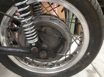

I ended up buying a complete set of spokes and nipples since obviously, spokes for a 200mm Grimeca rear drum aren't the same as for a 230mm Laverda drum.
For reference, the spokes for the Grimeca rear are 150mm, spokes for the Laverda drums are 140mm.

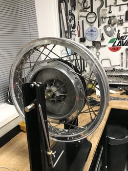

Due to popular demand, here is the wheel with my new spoke. It needed bending to get in and straightening after. As good as the factory effort.

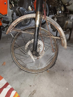

spokes.jpgFront wheel.jpgMy next project, my partially incinerated 125 Sport which seems a good candidate for me learn how to spoke.
