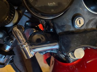

Hi, I am looking for a new stanchion (unsure if it is called so) for my fork. Diameter is 38mm, but how do I know if it is Ceriani or Marzocchi? Is it possible to know length of stanchion before disassembling?
Bike is Jota 180 from 1981, sold in Sweden, see pics attached.

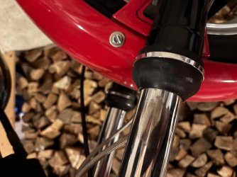

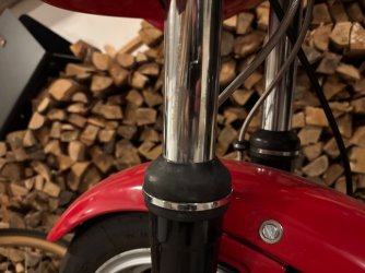

🙂 Many thanks for your quick replies. I am just thinking about replacing it, I am unsure if it is worth it. I have a kind of stain on the left leg, hard to show on a pic, but I will try.
I get marks on my new stanchions but that localised wear looks it's showing the nickel plating underneath the chrome.
It's probably been rotated in the yokes but I'd suggest it's worn or bent ( leading to a high spot which has worn the plating off).

Hi, yes I am quite sure it is original, it is not usd, must be the something strange with the pic.
New stanchion is about 285 euro at Laverda paradies. I cant see any damages at the other stanchion, do you think I shall replace both?

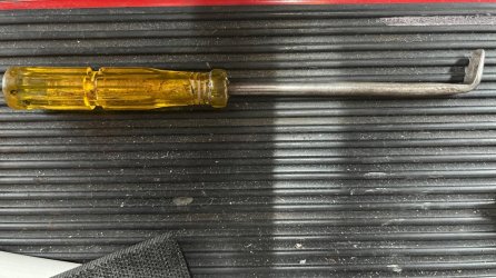

The seals pull out quite easily, one at a time.
Carefully lever them out with a long screwdriver, protecting the top of the slider.
This is my “special tool” for hooking them out.
