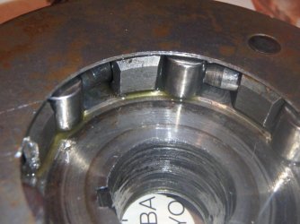

Just redid the clutch. 6 springs, pegs & rollers. All used. Rollers Ok. But will need new pegs & springs. Are these pegs & springs Laverda only? Are these still available w/out having to buy a brand new starter clutch? & I haven't put it on yet. It would be a lot easier to lay it on its left side but Laverdas are top heavy. Don't want a hernia. I always spill the rollers.

As above, Springs, plungers and rollers are all consumable parts and generally easily available from any of your favourite Lav suppliers 👍
Alternatively rollers are available from any bearing supplier. Springs are available from spring suppliers but you’d want to be reasonably careful to get a similar spec.
For reassembly I’ve found a little bit of grease helps to keep everything in place, however I’ve since been told not to do that, assembling it dry is a trick I’m still mastering 🤣
I'm still using the pegs from the 70's or 80s. The springs, rollers and ramp within the freewheel are the consumables - springs are def the first to go, and I've found that there are 'springs' and there are springs ... some seem to collapse a little too easily.
I used to put my clutch assembly together (starter chain removed, obviously) and fit it over the crank taper complete, with key in place.
With an assembly with springs in good condition I now leave the sprocket on the crank (again, chain removed) and fit the freewheel over it while turning the sprocket slowly anti-clockwise to engage it. If the rollers kep falling out your springs are not strong enough. You have to ensure the rollers remain in place and the sprocket can be spun backwards once the freewheel has mated with the taper. If it's a new freewheel you MUST ensure there is a few mm of lateral sideplay for the sprocket between the righthand main and freewheel. Disaster awaits if the gap s too small!!
And I assemble mine completely dry.

Have you got a split link on your starter chain? If not, get one. I use old triple cam chains and cut them to size. You should be able to do the reverse thread crank nut up quite tight without ANY friction on the sprocket. Even if it moves freely there's a good chance it will grab once the crank is spinning at several 1000 RPM. If you have hand ground the taper on the crank to repair it you reduce the side clearance. I check it all with and empty starter clutch to be absolutely sure. I had to machine off the inner face of the starter pulley to get sufficient clearance. I like at least 1-2mm freeplay.

Its on. Runs beautifully. Crisis over. This came about because I had not ridden it for a while had to get a new battery. Then discovered the starter clutch was slipping. I took the battery out 2 months ago. I fed it on a charger about once a wk or so. Ok I had no problem w/ starter clutch slipping before I took the battery out. It would start as soon as I would press the starter button. This time it would turn for about 2 seconds & then clatter.I was Surprised it even turned when I got it off. Most the pegs were broken up! Springs disarray...
