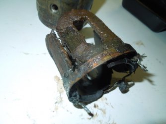

My starter motor died because the stator windings failed. I bought a refurbished motor from Malcolm Cox which is now on the bike.
I still have the old starter motor (still in bits in a plastic container) waiting until I can either re-wind the stator or find another buggered motor that has intact stator windings. If anyone has a fucked starter motor (for reasons other than burned out stator), send me a PM.
Why not have a go at rewinding it? It may take a couple of goes to get it done ok, but it's not rocket science! You just need some of the correct gauge enamel copper wire.

I am wondering what could go wrong. Easy for me to make the suggestion when someone else has the task!
It's difficult to get the windings as tight as they do in the factory where they're wound by a machine. So you end up with fewer turns which reduces the performance of the motor. Also, it's a tedious bloody job. Still, I've got nothing to lose by trying so might give it a go one day.

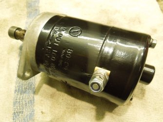

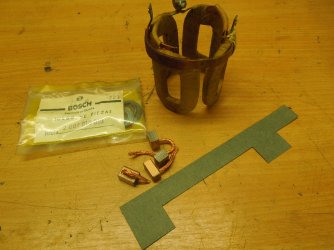

Reckon you're all up a dead-end street, especially regarding a DIY job on the field windings.  Both Bosch and SJCE starters use a rectangle cross-section copper strip, about 4x1mm, for the field windings, not the usual fine-guage wire normally found in electric motors.  I can't imagine that to be readily available to anybody outside the vehicle electrician trade.
NOS Bosch windings, cores and housings complete with windings are still available, the windings alone come to around ?60-odd.  These are wrapped, pre-formed and connected as a set of four and slot straight in.  Loosening/tightening the cores is another thing, and should not be attempted if unexperienced.  The complete main bodies are also quite reasonable, really doesn't justify a DIY attempt and messing around for weeks on end.  Even though they are dimensionally identical, Bosch and SJCE fields and armatures cannot be mixed, this reverses rotation direction.  The only truely interchangeable part is the brush holder with brushes.
Seems quite a few vendors try to finance their new yacht or weekend home with a single sale of "unobtanium", simply relying on punters not doing their homework. ::)

You're right Piet. I just had a look at the box of bits that was once my Jota's starter motor. The bloody stator is wound from rectangular section wire. The stuff is available (Here) but I don't like my chances of finding a local supplier.
I'd happily pay ?60 to resurrect this starter motor, if I can find a new stator winding. My starter motor has "Bosch, Made in Spain" stamped on the case, plus a bunch of numbers. I've had a look on line, and tried searching for those numbers on a Bosch starter motor website, but nothing comes up.
Piet - Can you point me towards a parts supplier for these motors please?

I'll have to check how many are left, last time I looked there were about a dozen main bodies and several winding sets on their own.  Not so sure about armatures, but they should easily be able to be rewound locally if need be, nothing special there.  No shortage of field cores and service kits, a whole box full.  Brushes and brush holders also available.
Bosch produced globally, usually where it was cheapest... nothing new there!  The pictured starter went to JLO, iIrc, it was also made in Spain.
OK. I didn't realise it was you who had the starter motor parts! Perhaps when international shipping returns to relative normality, I'll buy a Bosch stator winding from you. Rotor windings on my old starter motor test out OK so I think it's only the stator that's buggered. The thing was drawing about a million amps but not making enough torque to crank the engine.
