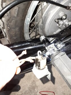

Just working my way through the issues. I have just put new spring on rear brake light switch I now have 3 wires that are no longer connected to switch with no idea where they go as there is only 2 terminals
2 grey, 1 black if I remember.
Have a look at the wiring diagram.
The greys if I remember go to the stop filament and the two brake switches, black would be earth.
But check.
