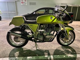

I find mine really comfortable - having the seat reformed after PO had cut a slice out of it cos he was a short arse ! The weight is nothing once moving 😆IMG_4607.jpeg
