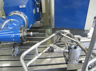

I am totally with you. It should not only be done by welding.
When I did mine I spend a Saturday morning in the company with our most experienced man an the huge milling machine and he made the final work at the headstock bearing rectangular to the swinging arm bolt.
