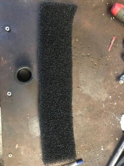

suggestions as to why these items were in montjuic petrol tank
fintanoc
ireland
just curious as to why these might have been in tank - it might tell me something about it's history -maybe somebody brought it into the bath tub and their sponge slipped in

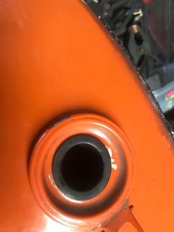

just see some mention of sponges being used in race bike tanks to prevent sloshing. the second picture shows the plastic piece fitting into the tank. it might have been to stop fuel rising out during refills. looking like the bike was raced
A tank would need to completely filled with sponge to prevent sloshing. It also prevents sudden total spillage if a tank springs a serious leak.
My guess is a cack-handed DPO decided to wash out the air filter foam in the petrol tank (facepalm!!!) and couldn't pull it back out.
Anti-slosh rubber, as above.
well the sponge is out - I thought it was going on forever when I got a grip of it and started drawing it out. now the decision to stuff it back in or not. now to decide whether I put it back into the tank, use it as an air filter or bring it into the bath as a sponge. Thanks for your comments
wouldn't put the sponge back in, looks like air filter.
The plastic insert in the fuel neck is commonly used in a usually unsuccessful attempt to stop fuel from a full tank sloshing out of the fuel filler under heavy braking, running off the front of the fuel tank, and all over the very hot exhaust headers and the rest of the front of the engine...... many of us have had that experience, usually more than once. I have spent all kinds of effort trying to get a stock fuel cap to actually seal, usually unsuccessfully. Best to try that fettling at time of painting the tank, you can adjust and bend tabs as necessary without destroying paint,
on my aftermarket carbon fiber fuel tank made by Boba I had him fit a flush mount and properly sealing aviation type fuel filler, with a separate pressure vent. The pressure vent has a drain hose that I run all the way to the back of the bike, don't want fuel on the hot exhaust or on the back tire.
the other interesting thing I have seen is where the usually leaky stock fuel cap actually seals and then there is a tank venting problem... is the fuel cap drilled through and a Dellortto main jet threaded in to provide a vent
the solution that was recommended to me is to never fill the tank more than about 3/4's, but sort of limits your range.

I found that plastic insert inside my 750 tank- it must,ve shrunk because it doesn’t fit into the opening. The cap was leaking due to a worn gasket made of leather and I replaced it w a square of gasket material
cut to fit
