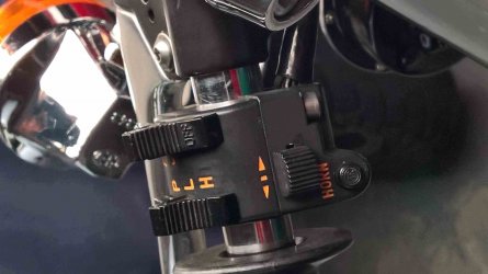

On the Laverda switches, I mask what I can around the lettering, and then use a fine tipped brush to fill in the letters with acrylic paint.  Then wipe off the excess paint as best I can and, when the lettering is dry, wipe off any smudges with water.  The acrylic paint, orange in my case, has held up very well.
