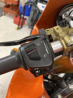

Bonkers price. I hope no one pays it. Wasn't so long ago these were available off the shelf from the Suzuki spares world at a very modest price.
280 euro!!!!!!! Rivet counters eat your hearts empty your wallets out.
if the year is correct, its a series II, (ND alternator) that means one alternator coil (for headlight main) is switched through the ND left hand item, early triples did not have this function (Bosch alternator of any output) so your Suzuki sourced switch needs to have that installed, there was another mod that needs doing of you use Suzuki stuff, from normally open to normally closed, a simple unsolder/resolder a single wire from existing to an unused blob (three blobs supplied, two used) it might have been the hooter?
EBay is your friend …… manage to get new left and right nos Suzuki switches for about £170 just took a bit of time finding them.
Some of the right hand Suzuki switches have provision for push-pull throttle cables. Possibly the GT750?
Might limit your choice if you have Mikuni or other carbs that have that cable system.
