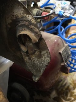

My original SF1 tank - very much looking worse for wear. But the angled stays are there - you get the idea.
