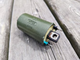

Hi, as the RGS sometimes starts running on just one or two cylinders after 15 minutes, I’m checking the electrical parts.
I have TEC MP06 ignition coils, but which is the positive terminal and which is the negative one?
Can you not determine that from the wiring?
I bought these used ignition coils; they’re supposed to be from a Honda. Unfortunately, there’s no ‘+’ or ‘-’ marking on them, just color green and black.
If the connection on all coils is identical it doesn't matter.They will work either way, just keep them all connected the same way.
