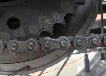

Having established (ruined) my credentials with the 3CL stamping question, I'll wait to be schooled on this one, too.
Anyone seen one of these, I sure as 'hit haven't, before? Every roller plate has holes in both sides! I thought I was hallucinating when I first noticed daylight shining through the chain.
I have seen stupid, lightening holes, weakening structures on many bikes, but nothing like this.The Weakest Link.jpg
Yeah, that is stupid- the proper approach are lighter/thinner 520 chain and sprockets as used on modern superbikes (but getting 520 sprockets for a Laverda would be an issue).
Hard to imagine that a previous owner would go to so much trouble - perhaps a chain supplier was providing such chain at some time?

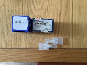

You asked a while back about points. I haven't bought any in donkeys years, I have plenty of stock to last me out.
Beru made points that fit, and it seems that Bosch can be found. 1754410274631.jpeg

Hard to read the BERU part number which claims to match the original Bosch part, please supply.
Does it directly replace the Bosch two piece originals or need modifications like the substitutes - is a picture of the BERU part out of the box possible?

Nothing unusual finding holes in chain link side plates. As long as the tension rating meets requirements, nothing to niggle about. Good way to save some considerable weight. See Enuma chains, also offered in a multitude of colours, for those that need that sort of stuff. Still rated at 4000kg.

There you are.
They look like this.
I haven't fitted a set of these yet since I doubt that I even change the points every 50 000 km and I only have two machines running points at the moment.

The Weakest Link> Definitely a chain with a Keeper Link using a clip. I ran an "O" or "X" - Ring link 530 and 630 Japanese chains oddly called a "KIWI" chain that will last for years with a little clearance filing in the out put cavity of the tranny because they are wider and hopefully will not rub the rear tire. With constant cleaning and using a silicon lube that Clip Link is still a constant danger - Always inspect that Link every time you get off the bike and carry spares.
You can buy a tool that will permanently link the chain to a specific length but when it comes to maintenance breaking a permanent link is rather a hassle.
Modern sport bikes all use a riveted master link and a special rivet tool “mushrooms out” the ends of the studs for a permanent joint similar to the rest of the chain. I’m assuming that the master link circlip on my 60 HP SF2 is sufficient but I do check it regularly. One brand of chains use an “X” master link that,s supposedly better than a standard master link w circlip. turning down old 530 sprockets is pointless since new sprockets are needed if a new 520 chain is installed.
I have seen stupid, lightening holes, weakening structures on many bikes, but nothing like this.View attachment 98370
I’ve seen that before, pretty sure it was marketed as a ‘Self lubricating’ chain.
My 520 Tsubaki VX only came with a split link, but to fit it you need to basically press on the outer plate using the special tool (the same one that peens the rivets) before you can even think about fitting the spring clip - enough RWHP to test it but I have absolute confidence it will never fail. And never had a spring clip link fail on any of the chains my SF saw over the decades.
Piranha: No such thing as a self lubricating chain. I believe Honda claimed it true on one of their dirt bikes were users neglected to clean their chain regularly and Honda dropped the promotion ;o)

There used to be a Laverda supplier who sold 630 chains for the 1200 with a spring clip connecting link ........ I found once after one of my regular motorway trips the clip was missing ....... It was only by chance I noticed it ....... Luckily the interference fit of the side plate meant I was able to continue at reduced pace to get back home again , but stopping to check every few miles to make sure that plate was still in place .... ( I guess I would have soon found out if it wasn`t ) ........
Carried spare clips after that , but the same thing happened again ......... I was in the habit of checking now , and fitted the spare link I had with me ......... but then thought what the hell am I doing having to check and go through all this bollocks for ......... Chain tension and alignment was as good as it was ever going to get ..........
So from then on , soft rivet links all the way ........ No problems ...... and with a 630 self luber ... ( or sealed roller link if you prefer ) ...., it got changed every 15,000 miles at the same time as the primary and cam ones ........ although I always wondered a bit about the spring clip on that cam chain ........
