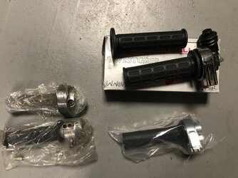

I prefer twinpull throttles, so that’s what I usually have, some NOS, some used.
Marnix

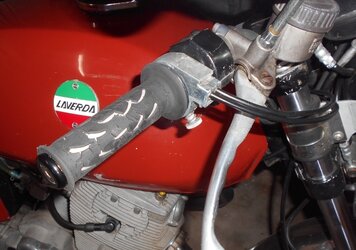

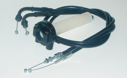

I agree. Twin cable is the way to go for twin carbs.
This one is stamped 'Germany'. I'm guessing Magura? Are they still available today?

Brilliant, thanks everyone, i'm heading over to the Domino site to see whats what.
I think I'm going to go singgle cable though as I hav the splitters that go under the tank and they are ingood condition as are the cable that come from them for throttle and choke.
Except for the USA models which had SF2 throttle system (and SF2 wiring as well). I ditched that from mine and went to twin pull and now I have a proper SFC wiring harness from Wolfgang. Also going to put Smiths tach in place of the ND's. Need to find proper clip-ons now.
