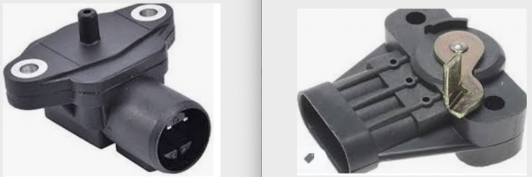

I'm looking for ideas, opinions and experience setting up an Ignitech profile with a set of Mikuni RS36's.
The 1200 runs well with the Ignitech (new install) so before I spend too much time 'tuning' (with no sensing) I'd planned to source a TPS (throttle position sensor) and go that route. However to engineer a linkage for the TPS (probably a lever type via a link to the throttle) seems harder and more prone to fail than to just install a remote MAP (manifold pressure / vacuum pressure) sensor via the built-in vacuum orifice on the Mikunis. This should serve the same purpose as far as the Ignitech is concerned.
The MAP is generally cheaper although a decent Bosch unit is also available which would be desirable over an aftermarket.
Any ideas? Could I just use a single vacuum port (normally blocked off and generally just used for syncing the banks) to run a MAP and any ideas as to what pressure is available ... most units measure up to 3 Bar. That would definitely simplify the plumbing and reduce the chances of leakage.

'cape' really went to town but so far I've just fleabay'd a genuine / new Denso vacuum sensor for a Honda CRV for $15 and with a few wires and a piece of tubing might get some results to report on.

Just for interest, the pics are representative of the units I'm gonna try ... both have 5v - 3 pin connections for the TCIP to interpret.
I guess I might be heading towards having to install a 'check engine' light (won't ever happen) but if I can set a profile that retains the original aggressiveness of the Laverda without too much fur and also a 'touring' profile ... I'll be happy!
