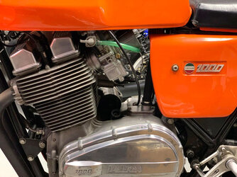

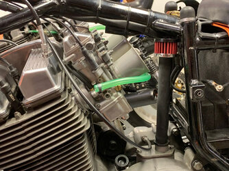

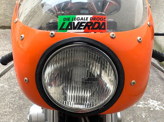

... like on all my LAVERDA triples, I mounted today a engine case breather with K&N filter to my old and faithful Sulzbacher LAVERDA 1000 3CL. Now the breather hose no longer ends in front of the rear wheel. Ciao, Gert

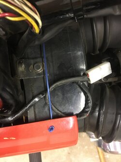

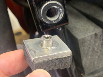

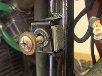

Gert, in your first picture, can you elaborate on the setup you have for the screw to hold your side cover on, is that a Laverda part. I have a 78 that only had the rubber bungs to keep the side covers in place (not always). I improvised a more secure setup but yours looks far superior, thanks.
Hi Dave, it is a nickel plated furniture screw with a transparent rubber disc underneath. I modified the side panels because without air filter box they tend to fly away ... Ciao, Gert
Yeah, I have had a few side covers blow off over the years, PIA. I have a secure setup now but panel removal is tedious, I got to work on something more accessible.

I'm thinking along those lines. Fixing a hook on the inside of the side panel with epoxy resin and linking the panels very much like you've done.
That might be a useful modification Gert, but it doesn't win any prizes in the looks department. A knurled knob would look neater, and would probably be more practical.
Ohh now I'm disappointed. I was expecting a design price! Maybe after 25 years I should think about a redesign ... Ciao, Gert
