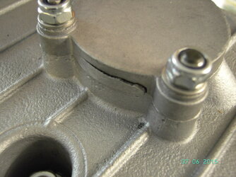

This filter flange had been cracked before blasting, but I missed the damage prior to re-assembly. A new correct o-ring put enough pressure on it to make the damage very obvious! Needless to say, I now inspect these very closely before re-fitting!

Alarming picture of failed casting there, wonder if also "bit of everything" casting material, machining of groove accuracy, gross mismatch of O ring cross section ( highly probable, its easy to have fat Orings in that diameter, not so easy in reduced cross sectional diameter ).
Upper housing has failed, not the lower bulky material, as i see it. j
Did the same on an inlet manifold years back, thought I would do the right thing and use a Vitron O ring instead of the completely crushed original one and that turned out to be too thick and snapped a mounting ear off. It's a painful message to learn.
