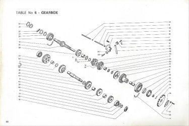

Support the stirrup (17 on the diagram below) from behind, with a thin bladed screwdriver.
Adjust the cable to line the cable end with the gap in the front of the stirrup.
