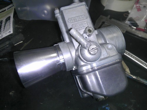

bought this from 22l  https://www.ebay.it/itm/DE-Lavatrice-Ultrasuoni-Pulitore-Digitale-3L-6L-10L-15L-22L-Dentale-Pulizia-220V/152740441840?hash=item23900a2ef0:m:mCAy_-s9j2wd01qJF_i75pQ
used with the Fulcron of the Arexons
15-minute cycles in hot water.
I put water already hot because the heater takes a long time to bring it to temperature, but it's okay to make it rise a few degrees over time.
Satisfied with the cleaning of the carburetors and much more.
[url=https://flic.kr/p/21ypsYu]
[url=https://flic.kr/p/21ULy7b]
It does not do everything on its own, but it helps to achieve these results  :D
