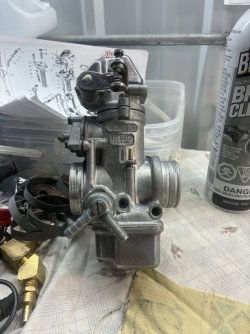

Not the best pics, these carbs have not been cleaned in at last 20 years, i used 1.5 lts of Mean Green and 4.5 lts of water, 60 deg, 30 mins, my first time using the ultrasonic, i think they look pretty clean

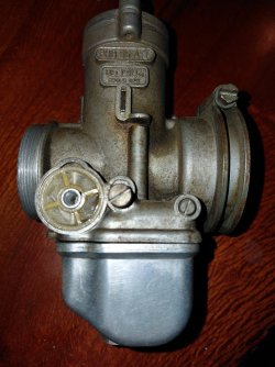

The carbs off my SFC. Thed 1st time they have been totally stripped and ultrasonic cleaned in over 50 years.
The cleaner was worth the expense.
Used a non alkaline water base degreaser. 60deg 30min
