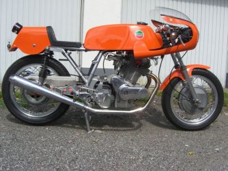

Can anyone identity what the exhaust system is on the attached photo? I like the upswept look. Looks like Conti cans, but what about the headers and mounting brackets? Custom?

Probably custom, wouldn't tale a pipe bender long to replicate those. As for te SFC brackets? But then again it wouldn't take long to cut out that shape from some 8mm ally plate :)
It?s possible to get more upsweep than std but with the frame triangle and the headers running outside the side stand and with stock centrestand it?s tricky to get the sort of effect shown in the pic. And the setup in the pic would have the headers dragging pretty badly in corners if you like using SFs for what they?re very good at.
If you lose the sidestand and modify the centrestand a la SFC you can get plenty more upsweep.

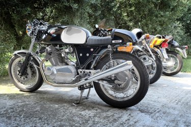

I assisted on building that bike.
The ex-owner had the headers made
fom stainless steel. Pic shows another
friend's replica with the same headers.

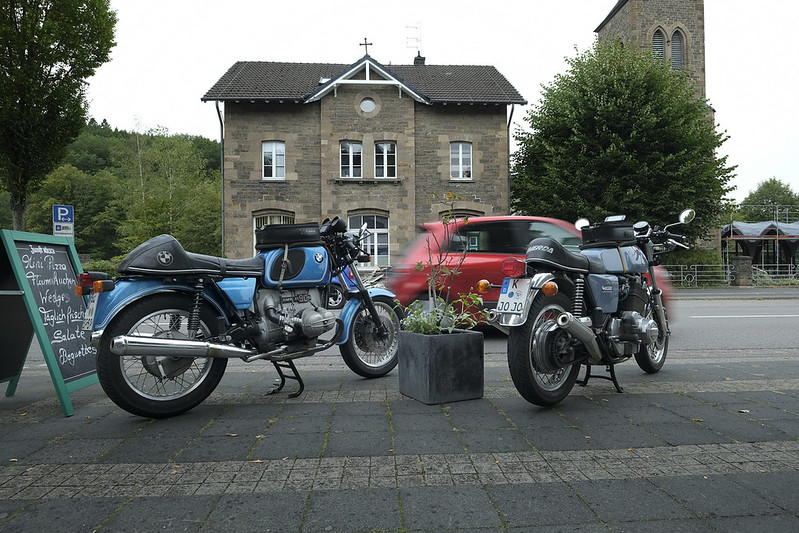

I have an R100 and a SF3, hard to tell which is quicker, maybe the beemer with the extra cc's. The SF3 definitely handles a lot better but is a much harder ride and vibrates more. The BMW is so comfortable and smooth but no slouch either. I use the BMW for long runs, especially when a lot of luggage is involved and the Laverda for those fun days to put a smile on my face.

there is a lot on that SF3 that makes me think that it was formerly owned by me, but then again it is very stock, smaller marks, eg chain guard are doing that, maybe just the chain guard is ex me, fork gaiters, front brake hose too long, bars and bar end mirror etc, how long have you owned it and what do you know of its history?
