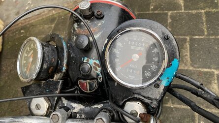

As you can see in the pictures it is a bit rough. My plan is to make it running again to check the state of the engine. Than fix it technically so I can have it inspected and the license activated again. And after that I will take it apart an make it look fresh again. Not planning on making it completely original, since it originally was red, and have been painted blue in its life also (pre 1981.) I want to keep it looking like a GT, only with some small things here and there differently. These changes will be driven by taste and cost probably, but the plan issn’t rigid.
I noticed in the papers it is called a 750GTF, does anybody knows where this F stands for? On the block I can find only “GT.”
Hope to get with updates soon!FB7C37CE-DA3D-4B14-8599-231AFC6A4DF4.jpeg21A6F951-F5DF-4981-8706-282CBD4E8F3F.jpeg7F526498-19AB-4448-A93A-856F60F77517.jpeg

Good on you Bram for keeping your uncles legacy alive. With only 53 thousand km (could well be genuine) on it, there is every chance the motor is in excellent nick. There is quite a bit of clean and tidying to lift it out of the "neglected" look but most of that is doable yourself if you are keen.
The Freni explanation sounds logic actually.
Nice to hear it could be the engine is in good condition, hope it is. I’ve been thinking about the mileage and I also think it’s correct. Can’t imagine it is 150k.
