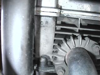

that "CR" stamp looks (a bit) fake to me.

you went to a lot of trouble to take that picture Adam, shame that the font is incorrect, the R is not stamped deep enough, the broken fins, oil leaking from cam cover, silcone oozing out of the joint, chisel marks on cam cover etc etc, still I would take it off your hands for a bag of sand to save your grief if that works for you.

errrr let me just think about that for a nanosecond - noooooooooooooooooooooooooooooooo enjoy it from a distanceCorsa right side (Medium).jpg

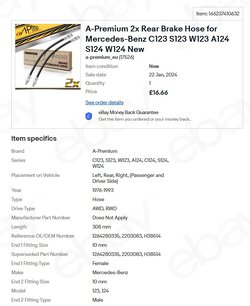

he said big end, not bell end, and anyway I just couldnt bear it on my property with the non stock grab rail, four piston callipers on Red brackets, and on the wrong side of the forks as well! I cant forgive the perished brake hoses (surely) complete with 1983/6 date stamped collar, when Hamish eventually got round to changing same on his 3C (done here at Knockholt after I pestered the life out of him)) we found that (un-beknown to him) one of them was wearing a flat where under hard braking, the oil cooler was grinding it away!
ps stock rubber brake hoses can easilly be bought for jack shit money, as they are rears from a Mercedes car, Hamish will advise which model I hope
