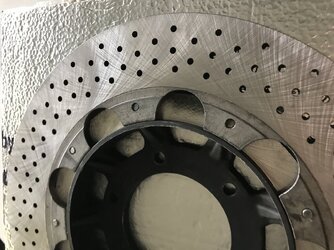

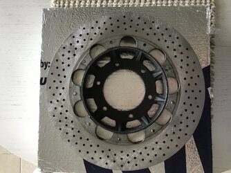

Yes, I received my disc rotors and carriers back today from Tom Tokarz @ Truedisk LLC in Michigan, my door to his and back in 8 days. Both discs and carriers resurfaced/grinding $110 ($55 each) +$36 shipping round trip, now that makes me a happy man. Check out his website, nice guy to talk/deal with. If they last only half the miles they had on them originally I will be very pleased. https://truedisk.net/
