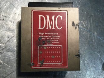

hello again, is this a wasted spark ignition, thanks

No, it's a DMC II ignition system manufactured by Moto Witt. It produces a wasted spark.

If spark is cam position controlled then ignition is compression stroke sensitive. If ignition is crank switched it's "wasted spark".

DMC I and II systems for 750s also run a wasted spark. The recent DMC 32 can be ordered without, means 2 single coils MUST be used. Waste spark system can run a single double coil.

When you refer to a wasted spark the rotor on the crankshaft will send a signal to the module every time it spins past the trigger, in the case of your 180 deg triple this will mean the double coil that fires the number 1 and 3 spark plug will spark this means when number 1 is on the compression stroke it will fire and at the same time the number 3 spark plug will also spark (not on the compression stroke) this is what is refered to as a wasted spark.

Maurice, to put it simpler, it sparks at every revolution, the "wasted" spark occurring durung valve overlap. Without compression, therefore not doing anything to influence the engine, other than using up electricity.
