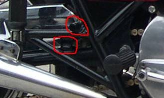

I used polypropylene  (25or30mm diameter) for my racing bikes - doesn't cause damage on that unexpected trip "Down the road", cheap, self "Nylocking", and non slip with grooves cut into them. Also prefer the "RGS" type gear/brake lever plastic toe levers as they ,once again, don't cause damage when grounded or change gear for you unexpectedly. - Regards - Phil
looks like a ribbed Dildo, and I don't want to know what the brown stain is..... :D

An interesting angle to have scraped away the gear pedal, Phil. Good idea the nylon, I have spare aluminium pegs in my racing kit.
Been "down the road " several times on the SF - only had to straighten slightly the footrest plates once or twice - the polypropylene footrests work out at about ?1 each. I have no spare Rgs gear toe pieces - but can use a smaller version of the footrest set-up too. - Regards - Phil
