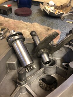

Just about to re-assemble the gear box change mechanism and covers after a clean up.
What type of grease would you apply to the parts within the cover/s?

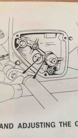

Oh no I didn't do that. No holes unced, it actually came away with the cover when I removed it.
Where do I start with getting that in correctly now, or will it be a trial nd error.
The selector with the pins is indexed by a line ground into the surface above the pins. That index lines up in neutral with a line scribed on the gear at the end of the selector drum which you'll see through a hole in the inner cover. The only thing which can be a bit hit and miss is the setting up of the eccentric which limits the movement of the selector "fork".
The large hardened washer to hold the pins in is vital.
Don't you have a workshop manual or a green book? Equally vital before doing anything on old metal that you don't know.
Thanks for the help everyone, you'll be pleased to know I have today got my copy of the green laverda twin and triple repair and tune-up.
The washer tht hold the pins in is completely missing on this bike so I'll need to source one.
When assembling things with washers/shims/fiddly bits I use Redline assembly lube. It is viscous enough to hold things together and completely compatible with engine/gearbox oils.
