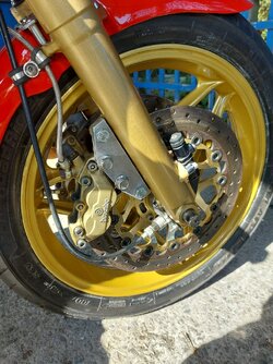

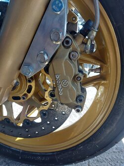

I have these callipers fitted to my 1000SfC and want to be sure what model they are before ordering new pads.
I have found nearly the same and probably pads would fit but would like to know exactly where they came from.
They appear to be Brembo P4 - will all single pin pads for them fit or are there any variances.
Thanks

Yep, P4 but generally referred to as Brembo 30/34 twin pot with single pin (as opposed to two pin). Not aware of other variances, but if you want to be certain talk to ducatipaddy
I took my old pads to the local Ducati shop, Gowanlochs to be matched. This isn't easy just looking at pics on the web.
