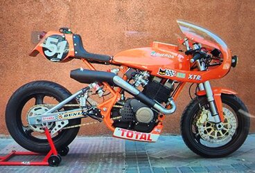

You don’t think it will level when off the stand with a rider aboard? On the other hand, if it does level out the swingarm downslope will be very flat with a strong tendency to squat under acceleration. The swing arm pivot looks a bit small too. I wonder if it is competitive in its class?
Maybe a calliper on the sprocket would help

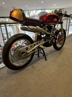

I wonder if Pepo built this one that I found in Argentina?IMG_0595.jpegIMG_0594.jpeg
Or is it just a copy? There is one very similar on his website that he made at Radical Ducati in 2013.
