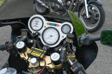

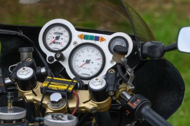

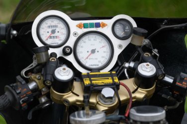

Hi Andre, I have mine installed above the triple clamp since years. They are Telefix ones in 41,7mm. You could turn the mounting ring potentially the other way around or simply turn it more than I did to get it more to the outside. I find them OK still.
laverda1000jota-sfc_low_bey-48.jpglaverda1000jota-sfc_low_bey-49.jpglaverda1000jota-sfc_low_bey-50.jpg
currently they are adjusted and mounted to 64cm rubber end to rubber end. If you mount them more straight and not that angled, mount them in front of the fork tubes instead of behind like I did, they can go up to 70cm easily I would assume, maybe even more than that. You could also mount them not hanging below the mount like I did but above, which would raise the seating position to more upwards, too.

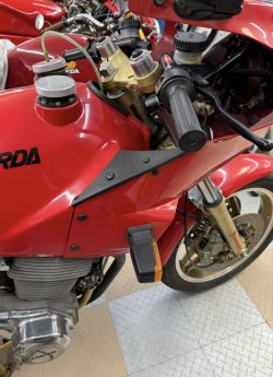

The width on these seems OK to me but the left side has greater forward offset from the fork tube than the right side which almost touches the upper yoke/triple clamp, whereas there is a 3 or 4-mm gap on the left side 🤣 If you remove them from the bike you can see the angle on the weldment is different. Anybody else seen anything similar or have a comment?
