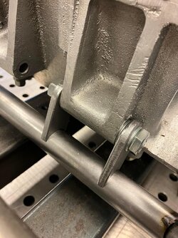

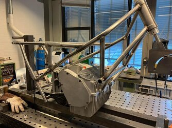

Here some picture, from my Spaceframe project, 3 new frame.
Br
Peder Heise

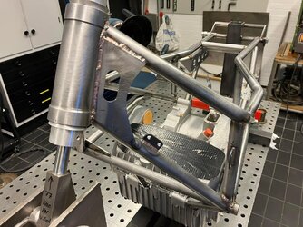

As another frame builder, I'd love to see a shot from back a bit to show your jig completely please
That looks like seamless tube you're using, what grade and thickness is it ?
Thanks

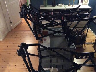

Hi Gert.
The first frame , is sold to my freind, Number 2 is for my self, and I Will make the Number 3, also to my self. I Will make the frame , so I Can use a 120˚ engine
Thanks
Hi Greg.
I use precision tube, 2 mm thick.

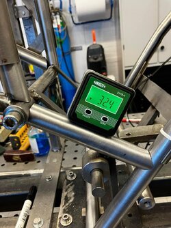

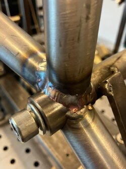

Some more picture of my project

Hi Chris.
No,I have make a tools
for shape, I have produced an Alu block where I can clamp the pipe, then I have a 25 mm milling cutter in the lathe, and then I can mill the pipe into shape, simple but super good
