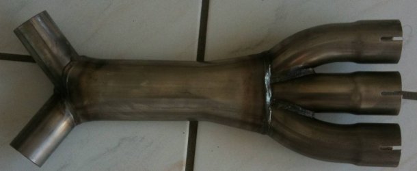

This is how the exhaust of my 3C look like, question is... is it worthy to restore them? or better to buy a replica? All tubes and exhaust are ok except the right silencer that has a deep scratch and a big dent, all others are smooth but chrome is very bad...
If you think is worthy... do you know somebody who does that sort of job with good quality? In Mallorca no way :'(

If you don't mind the bike being louder then you could buy a new system from someone like Malcolm Cox. Otherwise you may find that a stock system will be hard to find in new condition and probably expensive as well. You still have the small intermediate collector which will restrict you power a bit.

I don't mind at all and I even like it! a set from Malcolm is my most realistic option, but before that, I wanted to investigate the option of restoring... I like the idea of keeping those if it makes sense pricely. I don't consider a NOS unless I found a real opportunity (very unrealistic), so is either restoring or buying a replica set.

Depends a lot on whether you have a good chrome plating shop available?  Refinishing the originals is often more expensive than buying a new aftermarket one, but at least you know they are right.  Repairing those mufflers might be not worth the effort though, but those can probably be found in good condition second hand or even NOS?  Header pipes and collector I would certainly recommend getting refinished if you can and if they in a salvageable condition in the opinion of the plating shop.  The middle one in particular gets a lot of stone chips and takes many coats of copper and buffing back to fill the chips and get a good result without buffing the metal too thin.  Important to have a really good chrome shop!

Be careful if you need to cut open those 3C silencers.  Far from being empty, they contain a bunch of organ pipe baffles that run almost the full length of the silencer.    I found this out years ago when I tried to convert a spare set of silencers to open Jota cans.
If possible, retain and replate the three exhaust header pipes, condition permitting.  The pipe bending on the 3C headers is a work of art, I think.  Just about all the after market replacements I've seen simply don't compare aestetically.  And then the are alignment issues to consider.
Replacing the small tube collector with the bigger Jota version may be an issue if you retain the standard silencers.  When I tried it, my 3C had a huge flat spot in the mid range.  Perhaps rejetting would have fixed it, but I never got that far because I fitted Jota 'silencers'.  However, the big collector seems to work OK on the 1200's with their Lafranconis.

Keep the 3 headers and replace the rest Miguel, there are sometimes usable silencers for sale on leboncoin. Don't buy those awful seamed silencers from the later triples, they look really naff on the 3C.

With the used originals I would be surprised if any chromer would touch them. The carbon and other detritus inside pollutes their chemical baths. With a 'Jota' resonator you can blast the internals clean, making them acceptable for re-chroming.

I would forget about re-chroming. You can save the header pipes and collector by bead blasting or sand blasting, then either have them ceramic coated silver if you are desperate for a chromish look, or better black. For that matter, blast them then spray them yourself  with a couple of coats of high heat paint. You will get many more years out of them. I also have often used high heat exhaust wrap on the header pipes and the collector, not everyone likes the look but very functional. Lots of suppliers. Here is one.
