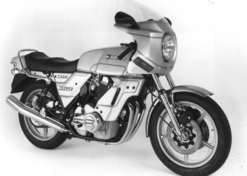

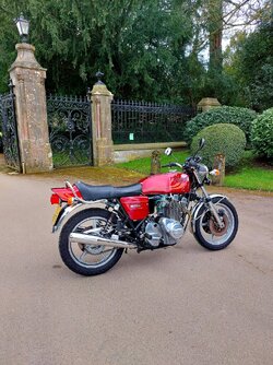

I think the differences between the 1200TS and 1200TS Mirage were merely an advertising effort on a poor selling 1200TS, trying to build on the earlier Slater Mirage reputation. I had asked Richard Slater about this not long ago and he said the UK TS Mirages came with adjustable bars and rear sets. These old photos show the two models, other than the badges and differences to side panel pin stripes, I don’t see any other changes. The TS Mirage had A11 cams and flat top Mondial pistons so it was a bit of a sheep in wolf’s clothes.
