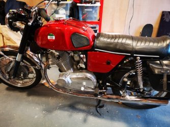

Interestingly, my bike is an early '70 wide frame, but I have the flat blades and slots. The blades do look factory as well.
My seat base is OK but a bit ratty, so I'd definitely be interested in a replacement or recover. I'm in Herefordshire.

Attached a photo of my 'baby'... 🙂
No, it's my seat foam thsts the issue. It's heavy, dense and the consistency of year-old fruit cake!

James ,I?ll give you the nod when Bob is in Laverda mode, is your seat foam ok ? Mine has flattened over time so will need a new foam.I absolutely love Your curved brace bars, nice bike!

Interesting James that your bike has the spades. I suspected that they were ex factory on some wide frames.
How are your tanks secured at the back James and Jason? The usual black rubber strap or two spring mounted metal clips to the frame?

Mine has 29mm carbs and the tank had a large hoover band but I suspect it should have the rubber strap with loops going to the two tank ?Vee? hooks. The saddle spears do look like an afterthought but they must have had trouble with the prong type. On the Laverdamania registry you can see there is no pattern to how the bikes were produced, very much made to order ,day to day which may account for lack of consistency in specification.
