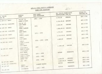

There were 630mm and 660mm tube lengths for the Marzo forked 1000s, I should think 1200 are the same.

I have a table with all the tube lengths, given me by Clem.
I could scan it if asked politely. Or maybe Clem has it to hand?
Hi Paul, that would be very nice if you could scan and send it. I would give you my next born child, or one of the preceding 5

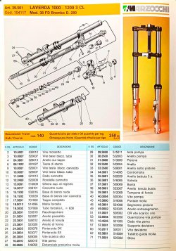

lavgert said:
Hi, here is the original drawing from the Marzocchi manual!
Ciao, Gert
Hi Gert
thanks for that, Im really after some dimensions in mm or something, but that is a handy document to have
thanks in advance
Will do.
