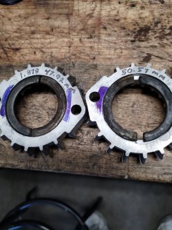

The Pipes I just installed 72 SF are from MALCOM COX from the UK. Just a work of art. He is fast and accurate in the fit up, I only had to make thinner flange collars on my lathe to fit the SF stock flanges due to his headers are slightly larger in diameter than the stock 1972 pipes. Still the pipes now look amazing on my SF750 , The photo included is the SF Engine Stock Flanges with collars from with different diameters on the counterbores for the Laverda flanges before I machined new thinner collars to grip the new pipes from Malcom Cox. sorry it's not in mm for the counter bores.
