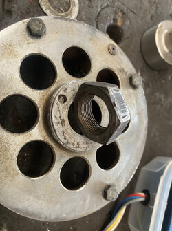

3c right hand side crankshaft thread badly damaged

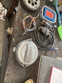

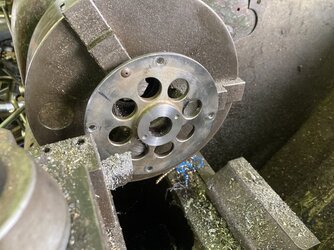

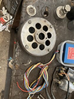

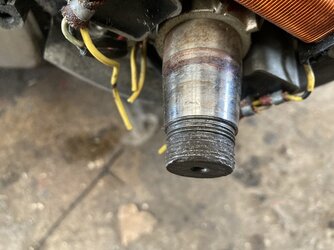

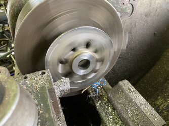

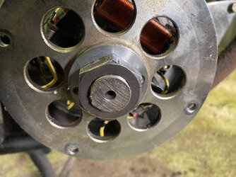

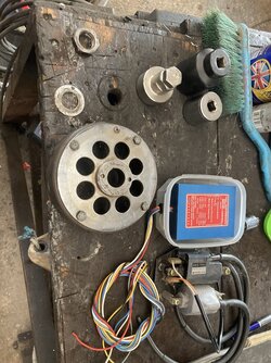

Well my lovely little Laverda people it’s not as bad as I was led to believe ,the thread is damaged but the crank is good, just the first 10mm of l/h/thread is damaged and weak where it has been stripped any thoughts would be welcome, I was thinking of turning 6to8 mm off the flywheel boss hopefully leaving me enough room to still attach the puller , again thoughts please5DF6FC81-0669-4AF7-B1D5-755E26ADD3E8.jpeg

Well my lovely little Laverda people it’s not as bad as I was led to believe ,the thread is damaged but the crank is good, just the first 10mm of l/h/thread is damaged and weak where it has been stripped any thoughts would be welcome, I was thinking of turning 6to8 mm off the flywheel boss hopefully leaving me enough room to still attach the puller , again thoughts pleaseView attachment 57414

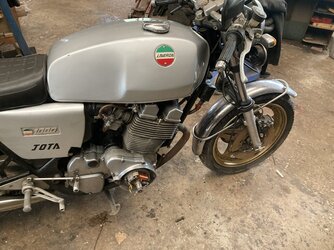

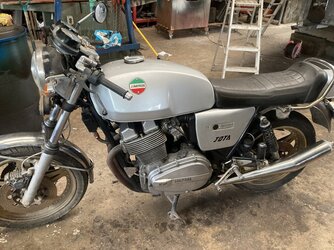

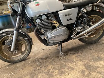

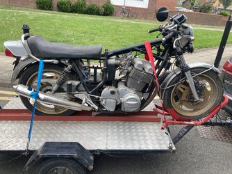

Looks like a proper barn find, well done. The Astralite wheels fitted have had rivet failures ( standard equipment on Heskeths!) this can be sorted by fitting new rivets. There is a guy who took on the Astralite repairs is up North-but I can’t seem to find his details. Corrosion sets in between the rim / rivet - so they look OK from outside .
I’m a bit sensitive to wheel failure as I test rode a bike with super lightweight magnesium wheels that literally fell to bits 20 miles later with someone else riding- he got away with it luckily!
If you are contemplating turning the thread down to a smaller size, (bush back to stock size? or bolt on size reducer) this will require the crank to be removed from the engine and at least the right hand part depressed from the rest, so (IMHO) I would be looking for a replacement part, I doubt that it will be hard to find, or massively expensive, The one on the other end (drive side) is in very shirt supply but at great cost is available, your puller looks like a stainless one, some time ago a well known UK dealer made a batch of these with the thread cut undersize, so that when you install it and attempt a rotor removal, it strips the 42mm thread, again a redilly available (used) part, there are plenty about since the Redax system does not use it.
so in both cases used parts is your friend if you ask me, but you don't have to do that, plenty of others will say the same.

Can you run a die back over it, to clean it up.
If I can find a L/H die I would , do you know what size and pitch it is

no problem, you are welcome

Thanks clem nice to know that this part is available
There not to badly corroded by the looks of it but I’m having the tyr off and painted

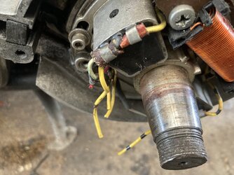

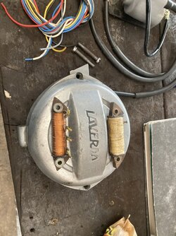

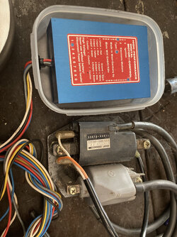

Using wire cutters is a rather brutal way of removing the charging and pickup board. Especilly if it was intended for re-use, which it apparently was because you need it with the Witt ignition system.
I posted a reply to your question on wiring up all that stuff in the thread about the 3C charging system.
