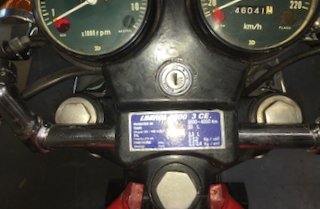

Hi Grant+
Here's two pics of the numbers on the frame of my bike showing 3CE...also of the yolks from above and side. Hard to do from beneath...do let me know what you think Grant+ and if other pics needed of yolks.
Matt

Thanks for your input Clem- hope you are well and able to ride a bit. I've added a pic showing the 3CE as you describe. I'm spoke to  Richard S. where I bought it and he says it is def. a UK bike imported by Slaters. He's happy to put that in writing but he can't do more as no record re 3CE.
I wonder if anyone else has records of 3CE's like SFC 750 list ?

A little bit hard to see with the shadows in the picture, but I reckon they seem parallel. Regardless of that your bike?s a 3CE in fine condition (as is your old SF), a shame you have to sell it, surely it will be appreciated by the new owner.

So I wonder if these 3Cs built at Breganze were stamped 3CE as special order bikes just for Slaters??
From your picture I think they are offset triple clamps they don't appear parallel to the head stock.
Very interesting history.

I?m not sure about headstock. Bit hard to photograph. See Clem?s comment on where 3CE added but he thinks done on arrival at Slaters. <matthale58@gmail.com>
look at the frames stamped 3CL and then look at the pic of Matts bike
The 3CL ones are all in the same font and all neatly in line, as in LAV.10003CL*????*
no evidence as such, but surely if the factory had stamped in the 3CE bit, they could have made the space, not so, the case with what we are looking at, and different fonts plus a very "amateur" and "added to" look to the job.
If Slaters were making the 3CE why would it be stamped at the factory???  :-X
As for the offset clamps, probably a photo from underneath the lower clamp with the steering stop removed would show the non-centric steering pivot.
