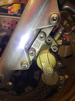

Not hard to make Dave, make a pattern with say 6mm MDF or similar [in my case perspex] to get the holes in the right place, calculate the off set and build onto the MDF to create the the recesses needed. find someone with a milling machine to copy the pattern. only need to do 1 side.
That's so much simpler than mine, mine is your typical triangle but the tricky bit is the changes in thickness on the mount that position the callipers central over the discs. I still use the original 280mm discs. I think the gadget in the pic was reversible so it could be used on bigger discs as well.
