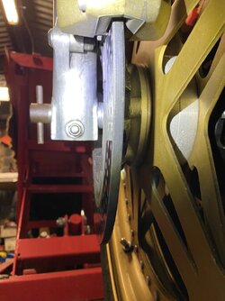

I have the GuzziTech caliper hangers, the mounting holes on the hanger to the fork legs do not have threads, maybe this method shown in the picture uses nuts on the bolts? ???
Guzzi tech is still around but under a slightly different name now : https://www.guzzipower.com/
GuzziTech hangers are now offered by Guzzi Power but only for Marzo forks. Yes, the GuzziTech hangers can be used for discs 280mm or 300/310mm.

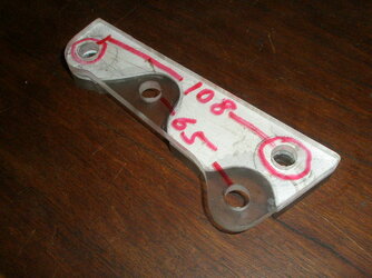

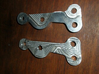

Thanks for all the replies, greatly appreciated. I might have to pull them off the bike and see if I can find someone to make a pair adapted to the Ceriani fork mount
Hand made a few adapter plates for both types of early and later forks, safe side, mild steel at 5-6m/m, spacers to suit for Nissin 4 pots. For others ( i see button head SS, could be wrong ) already "adapted" may like to reflect on the tensile rating for SS, given it could be any grade these days, as standards are not what once were, A2 A4 316 304.
Must use here, non plated 8.8 or 9.8, also check shear rating which for me precludes 12.9 ( had that 12.9 grade sheer on the fairing post on RGS, bloody dangerous ). HTH j.
Here ya go Dave, Is how I made mine. Pattern out of perspex and styrene, could be plywood/mdf.
Then you need to look for a new best friend with a CNC mill, or in my case my old mate Dirk who did his magic and they turned out sexy as.

100 % correct Bruce and yes the calipers are the same apart from the mounting holes, Ceriani threaded Marzo no thread.
Not correct. The tapped early type calipers have their mounting surface machined on the front face, while the thru-hole type have it on the back. That means that if just putting a thread insert into late calipers to use on Ceriani forks, the mounting surface is 'as-cast' so the fit of the caliper is a bit hit and miss. The ones I've converted I take a little skim over the mounting surfaces (requires the caliper to be stipped) to make sure they are flat and square. You can get by without doing this, some will fit better than others depending on how the casting was originally machined.
