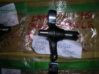

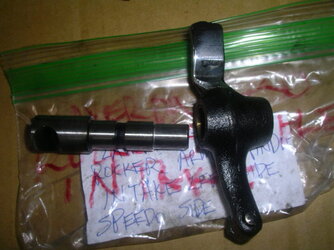

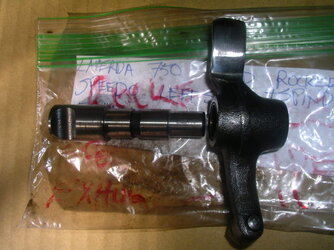

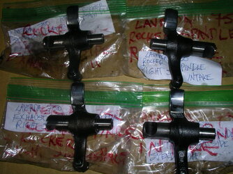

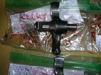

Pics show rockers. Bushings on spindles seem Ok. This head has about 40,000 miles. Reason for build up on valves. Back in 1988 I just put this head on one size over pistons. Just did the same last yr putting on used head w/ Ross Maxed out pistons on block 17580Sf2. Runs beautifully so far...But its on 15538 frame. Historically incorrect. Want to get 15538 engine back on original frame.

More Pics...Spindle bushes seem Ok. This head has about 40,000 miles

Followers look fine. If the spindles are reasonably tight in the bushes, all's well. Just some hammering on the adjuster tip.
Yep, all in very good condition. The rockers look to be earlier SF1 or prior to me. Not a problem, but they are heavier. From SF2 onwards they look to have been forged or cast thinner. But i wouldn't be concerned.
