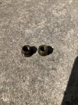

The GTL and one SF1 have OE brass nuts and stainless washers, the nuts are 13mm across the flats (right side on photo). The other SF1 has what I believe are the BMW type nuts which look like they are copper coated, splayed end, and are 12mm across flats, and three of them are seized.

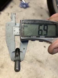

Am I measuring the stud corr3ctly? See photo.

More or less.
You should measure the threaded part.
