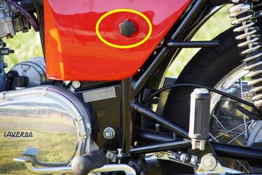

It wasn’t unusual for these to be replaced by the steel screws we all know so well, probably because they’re an item that’s fairly easily lost. However, my understanding is that the early GTs had these black side panel knobs as standard.I'm pretty sure those are more likely off a bevel drive Ducati or a Benelli 650 twin etc etc....common
generic knob. Why not get the proper ones from a Laverda parts dealer.
Early GTs and 650 did have those.It wasn’t unusual for these to be replaced by the steel screws we all know so well, probably because they’re an item that’s fairly easily lost. However, my understanding is that the early GTs had these black side panel knobs as standard.
If there are generic replacements for other Italian bikes of the era, then I’ll have a look and see what I can find as a ‘back up spare’.
You can find things approaching in M7.The ones with black knobs were M6 instead of M7.
Marnix
We used to have the same on the infusion posts in hospital.That’s great, thank you! I’ll measure mine up, get the same length in M6 and some rubber bushes. Perfect solution for parts no longer available.
Yes, yes I was looking at these and I thought they are so familiar, probably handled them thousands of times on IV poles and Swan Gantz line monitor clamps, who knew?We used to have the same on the infusion posts in hospital.
But they woulda had imperial threads, Dave. No good on an old Lav.Yes, yes I was looking at these and I thought they are so familiar, probably handled them thousands of times on IV poles and Swan Gantz line monitor clamps, who knew?
We don't do imperial threads.But they woulda had imperial threads, Dave. No good on an old Lav.![]()
But Dave does - in Sunny California.We don't do imperial threads.
Thinking about it, I'm pretty sure I've also seen them on good quality oldskool camera tripods, from back in the day around photography studios.We used to have the same on the infusion posts in hospital.
