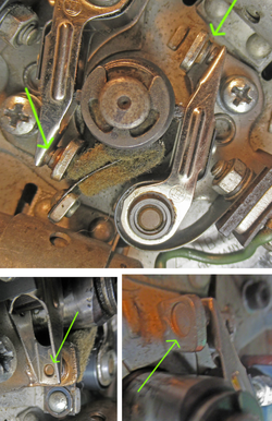

I see benefits to both systems and after some painful past lessons, I've learned that "if it's isn't broke don't fix it". I also am no points expert and attached is a pic of them. They appear thin to me but I may be mistaken. A friend has claimed it's possible to re-attach the pads that are apparently riveted in place. I see a rivet on the "arm" that pivots, but on the base, just a depression and hard to see how it's attached.
If possible, I would like to either replace or flip around the wiper pad before the metal tang makes contact w/ the shaft.

Look good to me, points, ( some have a spike wear ie migration of material one side to the other ) last you the life of the engine..... check the centrifugal mechanism behind the points, more important than these points ( which are serviceable in use ). Dial back timing light is going to help a great deal. Would not go the electronic route if mine. Transistor Assist ( TA ) system if you must should the auto advance be in reasonable condition. HTH j.

I'll keep them- please explain checking the centrifugal mechanism. Per the Green Book I checked the timing w/ a light bulb that came on @ 1" before aligning w/ the TDC marks.
Is it possible to replace or flip over the wiper before the metal tang makes contact w/ the shaft?

The wear will effect the actual span of adjustment available would think. The cam lobe is driven by spring retained weights ( condition of bearings/bushes is important ) it is not driven direct from the cam shaft take off ( if the case and not the crank ). The velocity of the centrifugal mechanism will "advance" the ignition to a maximum of around 32DBTDC, static timing is not all that important at cold crank start and idle rpm. 5-8DBTDC is adequate. You will not have a working figure without a timing light, not expensive and remove any mystery on what condition the advance and points are operating under.
Dwell, this is one of the great hoaxes to be not endured in this day and age. Dependent on ignition coil type, though a working figure of around 3-5milliseconds will achieve coil primary saturation. Say 7000rpm ( all advance should be had by 4000rpm ) assume cam shaft operated speed, 3500. 3500/60 seconds, 59 revolutions per second, 17mS for one revolution, 17/3 equals say 6 or about 15% of the cam to points being closed to saturate the coil primary. As you can see, the actual points gap can be very low and still achieve operating ignition. The wider the gap the less time for saturation available, ie the buffer block or blade can wear a lot before it is not acceptable, HTH j
Std max adv on SFs is 40 deg. Easy to pull the advance unit off (two 8mm M4 screws), remove circlip and cam comes off. Clean and lightly grease. Check centrifugal arms for free movement and minimal wear.
