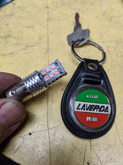

Problem solved. 2 leds for $8 free delivery. Don't tell tom, I think they're made in china.....

My GT doesn’t vibrate at tickover or leap around, I remember strobing a Norton Commando and it ran off! I think the round mudguards on the S/SF models aren’t as rigid as the squared type will vibrate more- this may contribute to tail bulb failure, mines been in since at least 1986.
