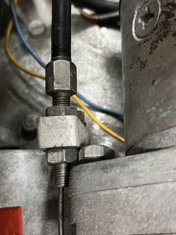

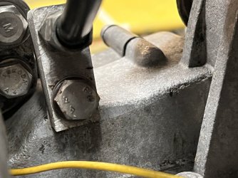

As Max notes, you have a non-standard extended operating lever which reduces the gorilla grip required by a standard setup. However, it reduces clutch rod travel to lift the clutch plates which means adjustment is very tricky and in my experience alters as the engine warms up so twiddling the handlebar adjuster is needed to compensate.
Inevitably the clutch lever pivot on the handlebar will be worn and this makes adjusting free play more troublesome. Your clutch cable appears to leave the bracket bolted to the crankcase at an uncomfortable angle - I'd adjust the bracket bend (or make a new one) to match the cable angle. The ferrule looks loose too? All adds to the 'fun'!

Mate this bike is new to me (6 weeks) and my first Laverda, so it's a learning process. The lever is well worn and the adjuster is a modified nut!

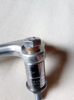

Your pushrods cannot be any longer going by your photo, and there is no point in shortening them. The pivot on your handlebar lever is completely worn out and is stealing effective travel. You could re-bush it and replace the pivot screw (if you can find one), on the Kawa lever I use the pivot is about 10mm wide so not prone to wear like that. As mentioned, if you have a standard lower lever you could fit it to see if the clutch disengages correctly, and if your hand can deal with it.
It also looks like you have enough material in the lower lever to drill a hole below the one used and get a bit more travel.
The worn lever pivot will cost you a ton of plate separation - esp with the extended slave lever further reducing travels. Hand lever should already have a bush - a piece of cake to replace that. Just push out old and in with new. Standard size.
Pushing in the new bush...
Before.... DPO had fitted normal threaded screw as the pivot!
