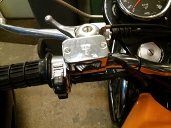

I'm fitting indicators to my 750SF and have been pondering what to use as a switch. Currently, I have a starter switch only on the right and High/Low and Horn on the left.
I was looking at this style as it would replace the starter switch and add the indicators plus a kill switch. Unfortunately, the only one I can find is listed as an LHS switch.
Has anyone had any experience with these, and are there RHS versions available? Or can the base be turned around to allow it to be mounted on the RHS?
Or what has everyone else fitted that look period?
I would just replace the left switch with one like in the picture. Blinker switches are always mounted on the left for convenience. Bloody expensive for one of those simple switches, older and dearer antique I guess.
Starter switch is fine like that, wires should run inside of the bars.
Shop around. CEV switches are crap, plentiful and cheap.
Ebay will turn up period crap rather than replica crap if you insist.
No need to pay more than €30.
The OE CEV stuff is as good as it came for the period. Simple, but made from decent materials.
Repro stuff is crap. The plastic base tends to melt away as the wires are soldered to the terminals, you need an extremely hot iron and need to be quick. A spray of water to cool off the solder quickly would also be helpful.

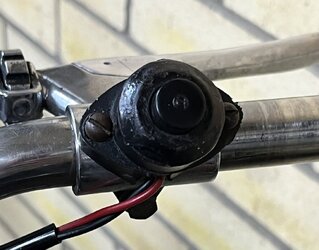

Fitted one of these to the Chott to keep the TÜV man happy, it matches the OE dip/horn switch nicely. They insist on indicators on bikes of that period, choice of switchgear is up to the owner... so, more to keep me happy.
Beware, repros are also often branded "CEV", my first attempt at soldering had it land in the trash. Pretty costly lesson, even these are not exactly a bargain. Keep the internals well lubed and they'll work quite OK.
Available from classic Guzzi suppliers.
